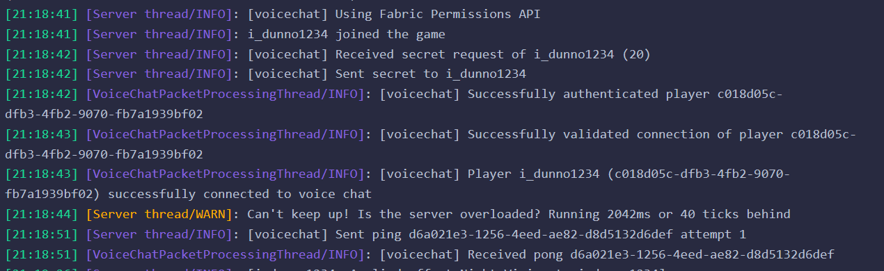

Server logs (successful connect over local network):
Server logs (connecting over public IP):
[21:56:56] [VoiceChatServerThread/INFO]: [voicechat] Voice chat server started at port 24454
[21:57:04] [User Authenticator #1/INFO]: UUID of player i_dunno1234 is c018d05c-dfb3-4fb2-9070-fb7a1939bf02
[21:57:06] [Server thread/INFO]: i_dunno1234[/192.168.0.237:62191] logged in with entity id 205 at (-511.6195736681106, 113.0, -216.69999998807907)
[21:57:06] [Server thread/INFO]: [voicechat] Using Fabric Permissions API
[21:57:06] [Server thread/INFO]: i_dunno1234 joined the game
[21:57:06] [Server thread/INFO]: [voicechat] Received secret request of i_dunno1234 (20)
[21:57:06] [Server thread/INFO]: [voicechat] Sent secret to i_dunno1234
