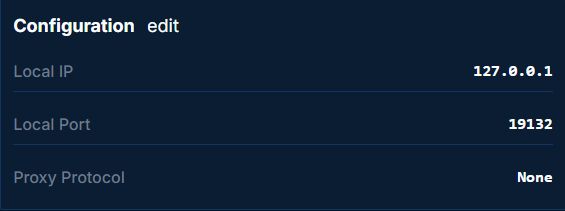

Part 1/3 (I can only embed one image per reply, so I’m splitting it up into 3 parts):
I realized what I said above was wrong. It does need two tunnels to work as dean said in his reply above. The experimental Minecraft Bedrock (NetherNet)tunnel type didn’t work for me with the v1.0.12 playit client. I had to go back to the simple TCP tunnel.
  1. TCP tunnel - 1 port - this is your “main” signaling tunnel. The default Bedrock local port number is 19132. Leave the Local IP as the localhost 127.0.0.1. You can set your custom domain for this one to give out to your friends, together with the public port number assigned by playit.gg.

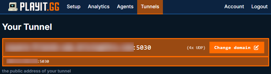

Part 2/3:
  1. UDP tunnel - 4 ports - this is where the Nethernet traffic goes. Enter 4 into the Port Count field as you are setting up the new tunnel. As dean said, you need to make the local port number Minecraft Bedrock server uses the same as the public port numbers that playit.gg assigned to you. Therefore, when you are creating the UDP tunnel, just accept the default Origin Config. After you have created the tunnel, it will have been assigned the public port number, and in this example, it is 5030 like below. Also, take note of the public IP address (not the randomly assigned domain name), you will need it later.
In my example above, the public port 5030 has been assigned to the UDP tunnel I created. Note the (4x UDP) label to show you that four ports have been assigned, 5030-5033.

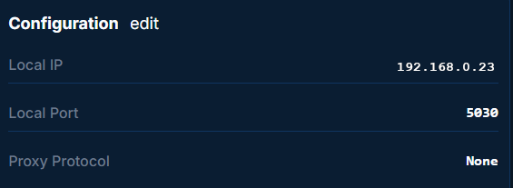

Part 3/3:
Now, edit your UDP tunnel configuration and fill in your Minecraft server LAN IP address (not localhost), and the port number the same as assigned to your tunnel, in this case, 5030. My LAN IP address is 192.168.0.23, so it looks like this:
Next, you have to set up the field in the Minecraft server.properties file. Look for the server-udp-ports field, by default it would be commented out with a hash #. The format is:
[ip:]external[-external]:internal[-internal]
So, take your public IP address that has been assigned to your UDP tunnel (not the domain), and the port number 5030 and it should look like the following in your server.properties file:
server-udp-ports=xxx.xxx.xxx.xxx:5030-5033:5030-5033
xxx.xxx.xxx.xxx is your playit.gg assigned public IP address.
Restart your Minecraft Bedrock server for the change to server.properties to be applied and you should be good to go.
